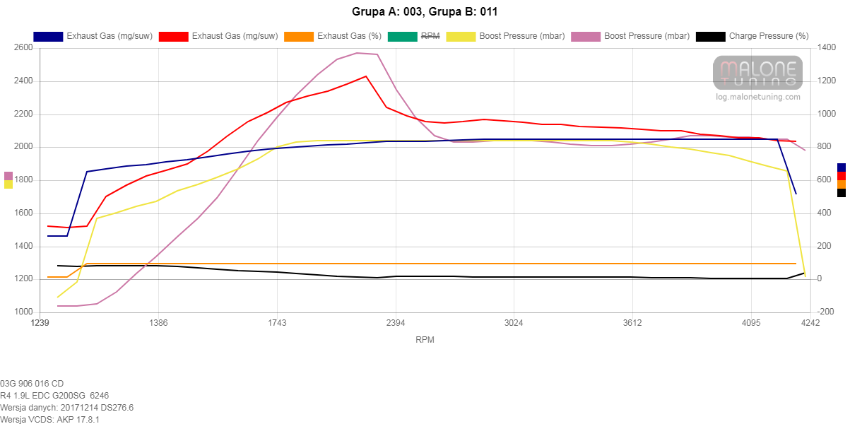

-- Śr sie 21, 2019 15:24 --
https://malonetuning.com/assets/uploads ... 294d41.png
-- Śr sie 21, 2019 15:29 --
prosę o ocene logów
https://log.malonetuning.com/chart/2647 ... AAAA%3D%3D
